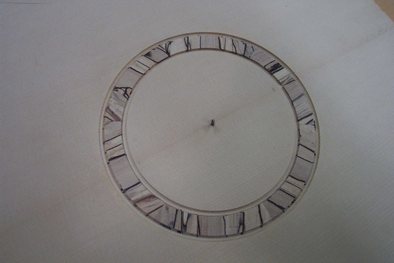

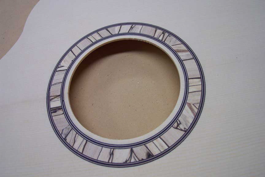

John, The way I do my wood rosettes is really simple and it works just as well for installing segmented rosettes.
I thin the material to around .070 then mark it with a compass or a template. Then I just cut it out with a bandsaw, and spindle sand till the line is gone and it fits in the channel. (It doesn't have to be tight it just has to be close) Sand this level. Then cut two more passes for the inside and outside purfling lines.
Here you can see the two passes for the purf have cut a little of the rosette and a little of the top to cover the sloppy fit we did putting in the wooden rosette sections.
I hope this makes sense, It's low tech, it's quick and easy, and it's always nice and tight.
Here is it when it's done...

BOB,
Just so I understand, do you make the 2 more passes for the purf lines after you have glued and dried in the wooden part?
I think this is what I was looking for, even if I did not ask it like that.

[QUOTE=jonhfry]
BOB,
My first top, the rosette just sucks and is going to be routed out and redone, the second and third tops have some pretty nice looking rosettes, but I did not put in a purf line so it kinda looks awkward. Next shop night I have I am going to try cutting out a small line outside and inside the rosette and install the purf I just got from LMI.
That's right John, I do one pass for the inside and one pass for the outside. What I've been using lately is a 1/8" bit (.125") which is just right for 2 .060" bwb purfs. (Or any other combination of .120" of purf.
Long
